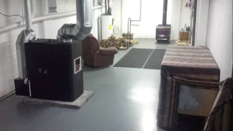

I like mine. I only have it hooked to one Main trunk of my HVAC that has 6 registers off of it. If I hooked up the other Main trunk, the airflow would be inadequate and i would prob throw beer cans at it daily. But only 6 registers makes the airflow pretty decent for an 800 CFM blower.
I have 2 registers in the kitchen, which is the same room as the Living room (one large open space) one in my daughter ls room, one in the kids bathroom, one in my sons bedroom, and one in our Master bath (hooked to bedroom/no door), so the Dining room, and Family room have no register, but the air from the 2 bathrooms, and the kids rooms has to come through those 2 rooms, to get to the kitchen/living room, so the cold air can return down the steps. It works amazingly well.
On the last few 25° nights, I have ran it on level 1 (feed trim 3 and combustion trim 5) and kept the house about 69°-71° depending on the room (kids bathroom and kids rooms are the warmest).
I also have a very large 3.5 cu ft wood stove about 20' feet away though. So all the hot air that is created by it, is sucked into the furnace and distributed throughout the duct. So YMMV
Meant to put pic in last post ;em
