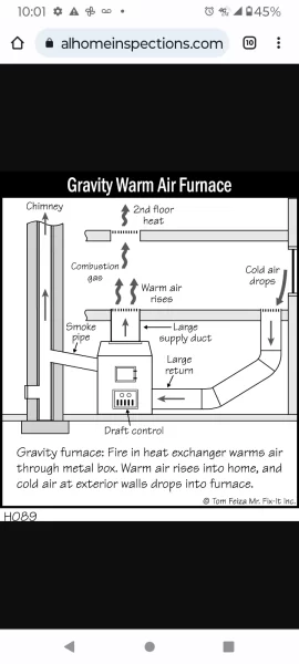

This is the jist if it, and I think a lot of the Amish do it this way, but it can be in a more common "ductwork" manner too, just need to make sure to have good rise on your runs (or fall in the return runs) and it needs to be oversized vs forced air heating.
It done correctly it could/would be pretty darn simple though!
