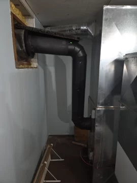

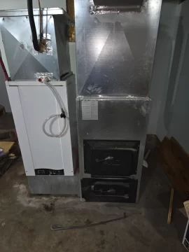

Hi all, I'm new to wood indoor wood burning. We bought a house with a falcon f-2500 wood electric furnace, company no longer makes stoves/furnaces. House is built in 2014 and would be pretty airtight which may be another issue. Plumber said should be a 4" fresh air intake near furnace, but there isn't. (might help, don't think it's the problem)
Last night overnight temp was - 10C (14f)
Wood is oak, moisture 15-16%.
We are having a problem with the fire going out when the time between Heating intervals is too long(I believe). When wood thermostat calls for heat it opens the fresh air damper at back of furnace.
Would there be another small vent which let's enough air to get in to keep fire from smothering?
Chimney was cleaned out, fire bricks had some cracks so I didn't take out. Do I have to take those out to clean? If so I'll get new bricks and can do that.

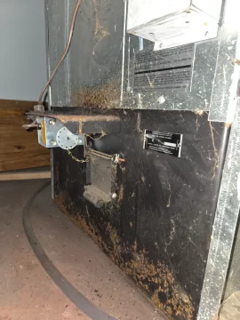

There has to be a little air getting to the fire between calls for heat...looking at the pic of the damper, there is a screw on the bottom there, with what looks like a tab on it...can that tab be turned to prop the damper door open a bit? If that's how it's designed to work, that is a little janky IMO...
Hi, bought a cheap tester and shoved the prongs far as I could and most pieces tested between 15 and 16. Wood was cut and split a year ago. Got the house down to 68 on weekend and tried again, added wood once and fire was burning nice, good coals. House got up to temp and went to check an hour later and fire was out and smoking like crazy.
So that little tab is for a power outage, prop it open and you will get some air to fire. It allows some air to circulate naturally through ducts with out getting too hot. When power come back on damper opens and the tab drops back down.
I could probably just tighten that up so it props open alittle at all times? Furnace Fan automatically kicks in if temp in exchanger(plenum?) gets to 130 I think it is, might just keep house hotter..
A trick that was commonly used by some on this forum running a certain brand furnace was to bend a paper clip to hang in the intake to keep the damper from seating fully.
Reactions: Burnin Since 1991
When I first moved in here, my furnace air draft was wired wide open. No T-stat in use. It was run wide open with only the fan limit switch as the only blower control. I soon had eliminated the wire and fashioned a hook so I could control the draft intake. I run it like a woodstove now. After I get it going, I adjust the hook so it leaves a 1/4'' gap at the draft door. Limit switch does the rest until the wood burns up. This is the way it's staying till I switch all to hydronic. If I ever pass go...
