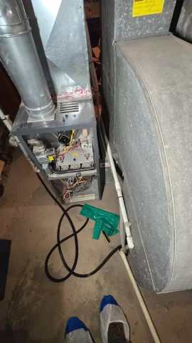

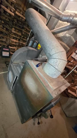

My name is John and I run a company out of Michigan called Breathe Easy. I am an HVAC contractor and we focus on indoor air quality. I got a call from a customer saying her carbon dioxide levels were very high in her home. I stopped by and her levels are indeed extremely high and actually the highest Ive seen to date. Im posting here b/c she has a wood burner attached to her furnace and I have 0 experience with this setup. I can say for sure that she, at a bare minimum, needs a combustion air vent in this room along with a few other things that I can rememdy but this setup just looks wrong to me. I appologize for lack of pics but I can get more. The furnace and water heater exhaust to another location and are not tied to the wood burner. With this install, I dont see how the furnace would not pull from the wood burner as she just has a manual damper on the supply line going to the plenum. Im also reading she should really have a back draft damper and the wood burner should be at least 10 ft away from the furnace. There is no room to move the wood burner 10ft away so I was wondering if anyone could give me any help at all on this? I am just way out of my area of expertise here but I really want to help this person out if at all possible. I would really appreciate any advice anyone could give me. Thank you so much!

There is no fresh air at all going to the room. I told her to leave her wood shute open for the time being. The CO2 stays high but I suspect its because all of the equipment in there with no fresh air in the room has started to supply that to the rest of the home as the company that installed the furnace has large holes in the filter rack and its not even sealed so all of the air is going around the filter..
The issue here is I really feel even with a combustion air vent run to this room, it wouldnt fix how this is installed. Im just not 100% sure what the right way is so she can get clean air

Does this install look ok though can anyone tell me that? Im thinking I will need a damper to close off the wood burner from the furnace when the wood burner is not in use so its not pulling when wood is smoldering. But even if I do a combustion air vent in here and put a damper in and everything, is this install safe? Another thing to note is she has 0 return runs in the basement only a few supply runs. I also felt like that could be a potential issue as well.
Also, wondering is she supposed to run the furnace fan and the wood burner fan at the same time or just the wood burner on its own? It has its own blower and I cant help but think if both blowers are running at the same time if that would cause issues. I didnt ask that when on site but thought to ask that here just in case.

A damper won't be air tight and thus won't resolve back flow issues.
There needs to be returns, at least to the basement, preferably right to the furnace(s)
This could be the whole problem right there...pulling a negative pressure on the basement

Exactly what I was thinking. I think she has multiple issues here. I think with returns in basement, backdraft and dampers along with a combustion air venting that should take care of everything. Also planning on mortaring that exhaust in for the woodburner.
