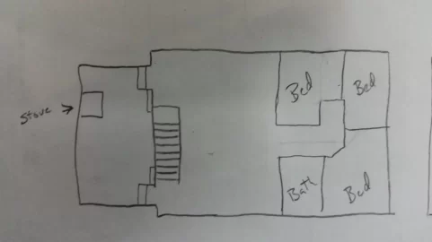

Hi I am new to the forum and a had a question about transferring heat to the other end of my house. My house is a 3 bedroom ranch with a addition/ family room. My stove is a free standing treemont with built in blower. My issue is in order to get my bedrooms on the other end of the house. The family room is like 90 deg. In order to get the bedrooms 70ish. I have contemplated putting a insulated 6 in. Duct with in line fans the get the heat spread out. Has anyone tried this.

This is a crude layout of my home. My goal is to make the bedrooms warmer. I seem to have a 15 degree difference in temp between the bedrooms and family room. And I don't think the cold basement stairs between the ends of the house help. Don't get me wrong it's bearable. I was just fishing for ideas to make it better
