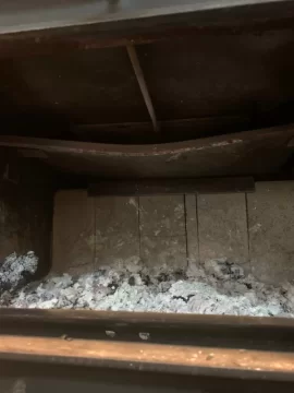

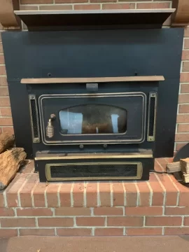

I think it is not catalytic. Exterior wall fireplace. Pics attached. Thanks

Is it hooked to a liner that runs out the top of the chimney? How long has your wood been cut split and covered? How are you running the stove?

Good questions. I've been told that it is hooked up to a pipe in the chimney but I don't think it goes all the way out the top. Also, my wood has been split at least a couple years- but is not covered. (I suppose that is a problem.)
The Nashuas were a little more sophisticated and had a basic reburn system that did produce more heat. The stout baffle was also a manifold through which convection air was superheated. It was a good stove in its day. The Treemont is more basic. The good news is that a modern stove will even do much better than either at heating well while burning less wood.
