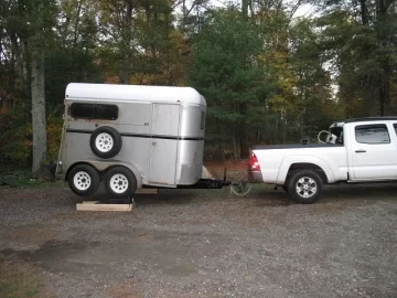

This is what I ended up doing!
Started with 14" at the back end, then on ramps 29".... made life a little easier!
