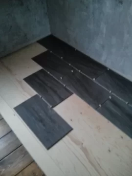

Anyone using non-traditional trim for their hearth floor? We have 12x24 porcelain tile we are about to lay on a large hearth. We are going to be short by 4 inches on the tiling, so need a trim. Wife wants a different trim rather than cutting the same tiles to finish it.

Maybe a picture of the hearth itself, and a pic of the tile so people know what color and texture you are working with might be helpful to folks who have good sense with this stuff.
I laid my porcelain tile hearth flush with my cut-out carpet. I bought some trim to finish it off with, but decided that it looked better without the trim. Without seeing your proposed hearth plan, I'm thinking that you may be best off cutting some tile. Once you do that, you can arrange the tiles so that it's not obvious. Probably even less work.
My first thought was to just use the same tile and cut them to form the border, but my wife is dead set against that. she wants something different. Anyway, here is a pic of the tile as we are playing around with how it will look. It's not officially laid yet.
