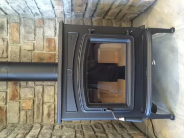

I run a Jotul F55 and load it N-S. 18" splits.
