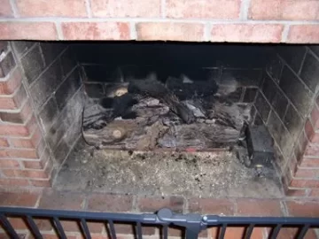

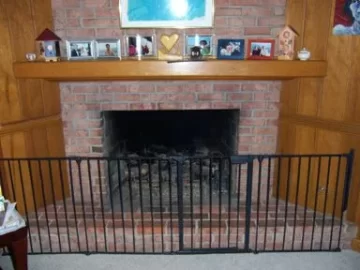

Here are the pics of our hearth, along with the nasty gas logs I've got to remove. Anybody have trouble with that? I already had the propane company come and take away the tank. Man, those gas logs are useless, can't wait to get an insert cookin' in there!
Looks like it may be down to the Hampton, but the deals not done yet. We like the Jotul Kennebec, but it's only rated at 55,000 BTU's vs. 75,000 for the Hampton, and the wife wants it toasty. Just have to figure out how to seal around the edges, hopefully it won't look too crappy.

I agree Corey. His fireplace is almost an exact duplicate of mine except that his is seven inches wider. Same height, around 32 - 33 inches. After many years with a huge insert I installed my step-top freestanding stove in that fireplace and the difference in heating is phenomenal.
