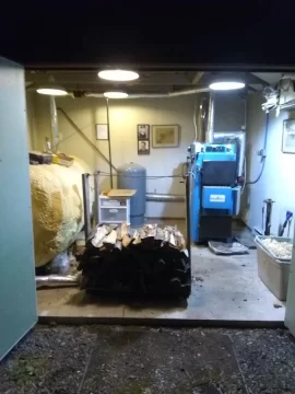

This is my second season with my Econoburn 300 and I have been having a heck of a time getting the boiler to gasify at startup. Airlina had shown me the way he lights his with the paper wick down through the gasification nozzle. This is hit and miss and lately at about the 1 hr mark the stack temperature starts to climb. Salecker , you had mentioned in a previous thread that it takes about 5-10 minutes to get yours to gasify. Please enlighten me as how you can do this. I was thinking about a top down fire to start.
Hi Mark
Yes mine is simple to get started.I use a piece of regular paper and make a roll out of it and push it through the nozzle.The i bridge across the nozzle with a couple of chunks,getting them across is nice i like to have some air room under the first layer of splits.I place a smaller split on each side of the nozzle and build my kindling in the middle.Mine needs very little,but i find you need smalls to get some coaling quick.Then i just keep building the fire placing the splits in a way that hopefully the fire doesn't bridge.
I will let it run with the bypass open for 5-10 minutes about the time it takes to load the wood cart.
I don't remember if you have storage?
My boiler is fairly warm when i start my fire each day.The gasification begins right away after closing the bypass i can hear the roar.Smoke takes a bit to clear and it will smoke if the fire bridges and collapses the coal piles on the sides.
Hope that helps feel free to PM if you like
Thomas
@salecker that is pretty much how I start mine too, since I redid my chimney last week and added 3 more feet of insulted pipe, I have better draft now, i use the paper roll trick, then some cardboard, then from there just like Thomas does, I now get gassification with 5 to 10 minutes as well, where as before the chimney upgrade it would take like 20-30 minutes. @mark cline how much draft do you have cold and when firing?
I have 1500 gallons of storage with 24’ of flue pipe so draw is real good . I think my problem is that I let the fire get going too much then the fire collapses and blocks the slots. A few times I would get it to gasify real quick but then I head back inside the house and see it smoking bad .Then back out and mess with the bypass and blower, then usually give up. Is there any proven ways to keep the coals from bridging? I was thinking of making some sort or grate out of 1/2” or 5/8” rebar. I’m happy with the stack temperature only getting up to 450 and hovering 400 to 450 ,the barometric damper was the key to that control. My radiant floor heat has been running 110 to 115 degree so my storage lasts to where I don’t have to reload most days with one burn getting the storage up to 175. Thanks for the help and have a nice Christmas, stay safe and warm.
@mark cline I can promise any metal that I have tried around the nozzle are is destroyed in very short order, I have that happen with small splits and the initial load at times, I can't seem to find a cure either, I think you have my number shoot me a message later, I may or may not be free but will try, I have to go home and fire up after work in a few minutes
Mark , I build my fire just as Salecker says and within 10 minutes I am gasifying (that sweet low rumble that sound like my intetines after a few bean burritos) and no smoke from the chimney. You will have to stir the pot occassionally because of the bridging that will occur as the wood burns over the slot to nothingness. I can tell this has occurred when i look out the window and see smoke from the chimney. In a 4 hour burn I usually check it twice after start up. A good Christmas too you and don't let Santa plug up your chimney on his way down. Bruce
Stirring the pot as you say won’t happen because I fill the boiler to top with wood before it’s lit. Tomorrow I may fire it up with about 4-5 splits and light it , then reload to the top after about 30 minutes. With my knee surgery, it’s not like I can do much , but really hate to sit and watch tv for more than 30 minutes. Knowing I was going to have both knees done over the winter, I figured I would need help moving the wood into the boiler room. So I bought myself a power assisted wheelbarrow. Yep it runs on 24v , has 3 forward and 1 reverse speeds , so I can load it up and move the wood in while the boiler heats up, a couple loads and I’m good for 3 days.

I have been starting my boiler with 5 splits on top of paper and kindling and light up through the gasification nozzle , leaving the lower door open a bit , I let the fire burn up to 300 stack temperature. Then I close everything down and it’s got the low rumble and a little blue smoke, I let this go for 45 min to an hour, then fill it to the top. It then burns with no smoke for about 6-7 hrs and storage gets up to 185 -190. I cut my wood 22-24” and a full load is 8 cu ft or about 200 lbs. Very happy with the way it runs now and wood consumption is down considerably.
Thats great Mark, I knew you would find a good technique(thats pretty much how i do it as well) for your monster 300 and in the nick of time too with a nip in the air this week. Hope you're healing up well from your surgery . Gotta go load the boiler.
Wondering if anyone has found any good solutions for door gaskets? I've used the factory 7/8" braided gasket to replace mine but I've been seeing a few people using silicone coated door rope that lasts quite a bit longer. Just seeing if anyone else here has tried the silicone coated stuff.
@filthymic - I have not tried the silicone stuff, however, I did find that 1" rope will fit in place of the square rope.
High flue temps has been my only issue with my Ecocnoburn 200 ,but with a couple modifications they are way down this year.
@salecker - what are high temps and what are they down to this year?
@mark cline - this sounds like where I was at last year. What size chimney are you running?
Last year I had a 6 inch chimney due to a temporary install. And I had to be sure that temps were high before I closed and damper and turned the fan on. It took a lot of time. This year, now that I am permanently installed, I finally have 8 inch chimney and can gassify in a few minutes. My lighting is similar to @cumminstinkerer
Honestly, my whole problem was that I didn’t understand how the boiler gasification process worked, after research and reading the Eko sticky, I realized that the coals need to be covering the nozzles . This loading and firing technique, has increased my efficiency, tremendously. One full load of wood gets my storage from 130 up to 185-190. My goal was to just load , light and go , but I learned that you need the coal bed , in order to get good gasification. Left knee replacement surgery is scheduled for March 17 . I need to clean the turbulators in the next few weeks. I’m looking for the materials to make the cutter head , I don’t have any broken bandsaw blades to work with , but I’ll come up with something. 8 in double wall pipe 20 ft . Thanks Mark
