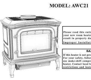

I thought the Ashley King was a pellet stove. Not sure which wood stove model this is. Is this the stove?

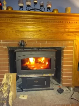

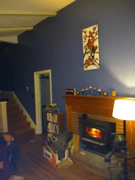

I finally got a moisture meter and its all around 26% or more. Def. wet. My husband swears that there is only about an ince of space in the corners of the chimney where the liner is not touching the walls. Would even that small space make a difference? Hes VERY reluctant to try and remove it from the fireplace. Could we do insulation around it, wedged in behind the stove?
This is my stove setup. It's really wedged in there, and the collar is not sealed tight either, I was going to calk it if it would help.

this is the model. (broken link removed)

You are going to need to address some clearance issues to operate the stove safely. The wooden mantel and surround are too close to the stove. You need 18" of ember protection in front of the stove. Not sure what is behind the steel plate inside the fireplace. but you need 18" clearance to any combustibles on the sides and 12" to the rear. The steel plate does not eliminate this requirement. These clearances can all be found in your stove manual.

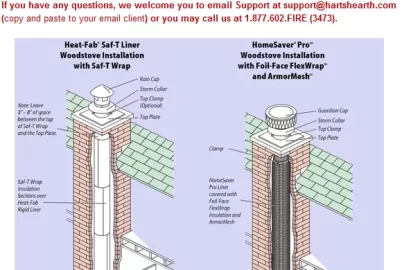

Yep, a lot of warm air goes out through those corners, and sucks cold air into the house and across the floor, making it uncomfortable. Best, as mentioned, is to install a block-off plate, but for now you can make a temporary one out of Rockwool or other fireproof insulation and install it right where the liner leaves the fireplace, between the lintel and smoke shelf.
By "cap on top of the chimney," do you mean a top plate with a rain cap? If so, seal it at the top as well. Take off the top plate and stuff Rockwool between the liner and the clay tile.

As noted, the stovetop is much too close to the mantel. In the least, add a mantel shield.
Yes I have planned to add a mantel shield. I guess I don't understand how one can extend the chimney top? It would have to come up 4 feet past the end of the chimney?
None of the walls on the side and rear are combustible. It was a working fireplace to begin with. The liner is cast iron. I do plan to install a mantel shield, because I know that wood is to close and I don't think I can convince hubby to take it off completely.
An anchor plate is bolted to the top of the chimney. Then a section of class A chimney pipe can be attached.
