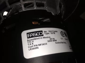

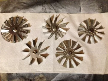

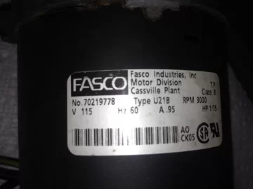

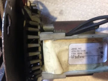

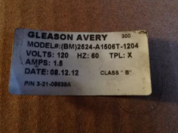

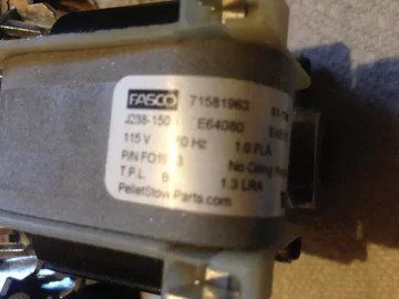

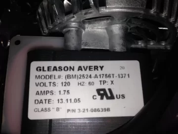

2. Open Frame or Close Frame 85 CFM which do you prefer?
Makers of Open Frame motors claim they are quieter. Close frame can be more protective
Does having a heavier magnet with a higher current capacity make it last longer?
It would start easier and run smoother.
Usually the higer current motors are used with larger impellers for greater CFM. This is true but high current motors with the standard impellers can last longer.
Also is the 1.0 FLA rating a way to make a smaller motor seem as good as a 1 Amp motor? The magnet is not as big.
So I have found that Gleason-Avery makes a nice 1.75 Amp Open frame and Magnum makes a nice 1.6 Amp closed frame. They are better, and I do recommend them.

For example:
Upgrading the Jakel 1.0 Amp motor Enviro uses to a Gleason-Avery 1.75 Amp motor is a nice upgrade.
Comments. See pics of the different amp motors I have below.
Pics 1 & 4 - Closed Frame 0.95 Amp, 1.0 Amp
Pics 2,3 & 5 - Open Frame 1.0 Amp, 1.0 FLA, 1.75 Amps
