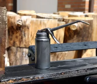

I have a little antique oil can I keep filled with 30-wt oil (seems to me that this was what my MTD 27-ton owner's manual recommended), and I just squirt some of that along the beam, under the wedge, & whatnot from time to time. Lubricates, discourages corrosion, maybe even quiets it down. I don't really cotton to direct metal to metal movement without some lubrication. The 30-wt oil just sort of mixes with the wood fragments & dirt and forms a nice adherent layer of oily lubricant gunk. I think WD-40 would be gone in short order. Rick
  • [Hearth.com] Troy Bilt 27 Ton - or - any gas powered log splitter
