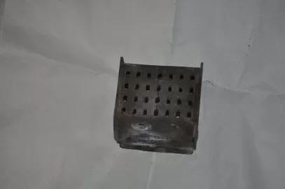

Does this burn pot need to be replaced?
If all the holes looked like the top (I assume that's metal , not carbon) then its getting along and will need replacing soon...that crack isn't good either...

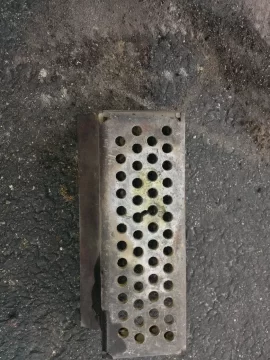

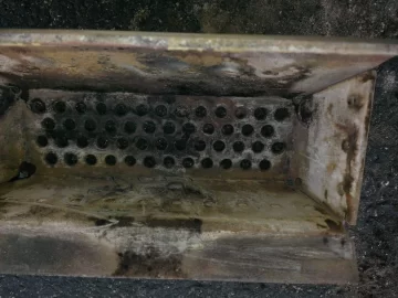

Adding pics....

Adding pics....
Almost the same issue with our Elena. Just cleaned up the area abit and spotted some stainless on the area and has not been growing.
