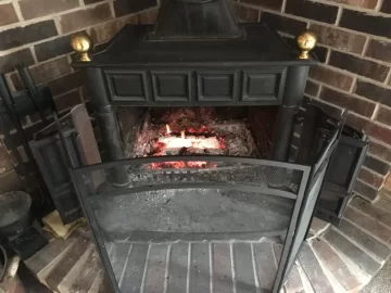

I have an older model stove that came with the house. I wouldn't buy a house without a stove. I'm trying to figure out how to get full efficiency out of this thing. Should I burn with the doors open or closed ( it puts out more heat open) to me it seems to use more wood closed. The doors are iron (no glass). I know to get better efficiency I need a new updated stove but I'm the cheapest of skates.

That is an old franklin stove and you will never get any efficiency out of it. The stove was designed by benjamin franklin as a replacement for open fireplaces and it is slightly more efficient than an open fireplace simply because the firebox is open and free to radiate heat but they suck tons of air just like a fireplace. The design was reproduced by lots of companies in the 70s and early 80s. Also what is behind that brick wall? If it is just over top of framing you have some pretty serious clearance issues as well.
If you insist on keeping it burn it with doors closed. Running it with the doors open is borderline negative efficiency. Unless your wood is free and you don't value your time whatsoever, its false economy. Buy a used box stove or an new Englander and you will be far better off.

I think the theory with the Franklin stove was that when the fire was dying out the doors could be closed which cut down the draft up the chimney. My dad used to try to heat with our fireplace and inevitably the cold draft all night cooled down the house. He built a wooden plug faced with asbestos cement board that fit in the fireplace opening so that we could close up the opening after the fire was dying out. It made a big difference.

We had the identical Atlanta Stove Works Franklin when I was a kid. It was in a family room addition. It worked well but ate up wood. That didn’t matter to us since a friend who installed fencing gave us an almost endless supply of old cedar fence rails and posts. We also had a lot of woods around the house. We burned around 50/50 with the doors open and closed. Use it with the doors closed, as long you feed it wood you’ll get heat out of it. Use it until you can install a newer stove, assuming the current setup is safe. These stoves will heat a room but not efficiently and only while there is a fire going. My father kept the heat off in the room our stove was in. In the morning the room was cool. We used it like a fireplace, letting the fire die down before going to bed. Be careful how much wood you put in especially with the doors closed, too much wood and it will fire like a blast furnace. There is almost no control of the combustion air.

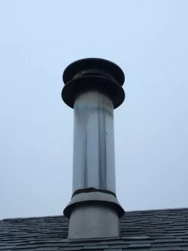

Here's what it looks like from the ground. Not sure if this will help anyone or not. Didn't have a chance to get on the roof.

How big an area are you trying to heat? There are a few modern stoves that use an 8" flue but they tend to be for heating large areas and/or will cost some bucks like the BK King.
If the chimney is in very good condition it may be one time where getting an old Fisher or Fisher clone off Craigslist would be the good choice. Those will out perform what you have. If the chimney is at all questionable I wouldn't replace it instead just go with 6" and new stove when you can swing it.
