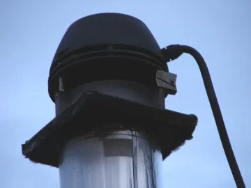

Do you get a lot of smoke out of the cap when burning?
We do get a fair amount of smoke out of it on occasion. I thought it was more when the air is what I call heavy, not sure if that is when the humidity is high or not. Joe said he doesn't think the air has anything to do with it and he says it is only when he loads the stove. I do know that there are times I can tell when he has loaded the stove because I will be in my office and sometimes the doggie door will allow the smoke to come in. The smoke will stay low in the air and congregate under the awning over the dog kennel - I think on the night the air is thick. Again this doesn't happen all the time and I do think it is related to the air, but if Joe doesn't think the air has anything to do with it, then maybe he thinks it is the quality of wood he may have used on that night.
There are many night that the dog goes out and comes in fine, but other nights that she goes out and comes back in smelling of smoke. Usually we can see smoke coming out of our stove, but not always, usually it is a light opaque smoke, but sometimes heavier/thicker.
You might be smelling smoke that has gone out the chimney and then leaked back into the house through windows, doors, etc....
Is there a real reason for the Exhausto cap besides trying to prevent smoke in the house? What I mean is, was there some sort of problem without that prompted you to install it?

The only reason we installed the Exhausto was to prevent smoke from escaping through the door when it was opened to reload the stove. With my asthma (I wheeze daily even on meds) we felt that the only way to really be able to have a stove and it not bother me was to have an Exhausto fan. We have been using this stove and that fan effectively to heat the house until last season when the smoking started, and it has carried over to this season....but like I said, it is not all the time. It is maybe 2 to 3 times a week, and then only on cold start up and only for about two hours and then it quits. It is just the strangest thing.
Could the exhausto be pressurizing the stove pipe and chimney? Stove pipes and their joints are designed to operate under a negative pressure. When you add a forced air fan you could be pushing smoke out of the joints. Have you checked for a clogged cap?
I believe the fan is on the end of the pipe on the roof, which would create a greater negative pressure in the vent, not positive.
If the problem has not always been there something must have changed. Either the wodd supply has changed causing more smoke than in the past, or the chimney has changed somehow and it has more restriction than in the past. I would also seal up those pipe joints just to make sure thats not the problems.
Also, once the fire is going you should be able to burn just fine with the fan OFF. You shuld burn less wood and get longer burns with the thing turned off. Unless it has to be running for smoke to get out? Then I would put it on the lowest setting.
I would check the cap and remainder of flue for stoppages before looking at the stove much more if you haven't already. The old King heater out in my shop smokes at every pipe joint when the cresote begins to form just inside the exterior flue. After 20 minutes with the wire brush everything works as good as new.

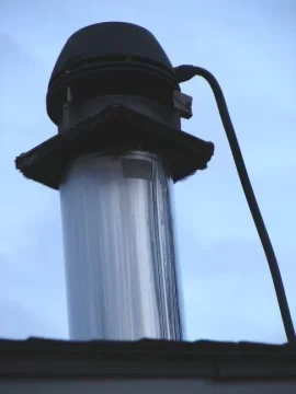

Here. I thought I would post a couple of photos of the Exhausto fan. It has not started raining here yet and it is not quite very bright outside but they turned out okay with lightening them up a bit.

The flue is 13' from stove to exhausto.
We have been way ahead of ourselves with wood. We have about a 3 yr supply and have had for a while. So, the wood we are burning is very dry. Joe keeps the current burning season's wood under a lean-to off our garden shed where it can stay dry.
Yes, Joe said he does clean the Exhausto and he checked it about a month ago, no issues with it.
The only thing he has never done before is remove the insulation (where the stove pipe fits into the stove) and clean around that and there was a lot of soot, dust, and some creosote there - hopefully, maybe, that was the issue.
Sounds good, I have seen a lot of junk accumulate at a bottom 90 elbow too. With a short flue, the stove needs a very clear passage all the way. If there's enough crud collecting there it can definitely restrict draft. Good to hear the stove is back up and running fine again.
Every time you clean the flue you need to take out the tubes and baffle to get all the creosote out that fell down. Or you can do as you did and take the pipe off the stove and get it out that way.
Thanks BeGreen and jtp10181, I think Joe learned more through this experience about going the extra length when cleaning. Hopefully this will have solved our problem.
Barb
We started another fire in the stove last night (after having cemented the stovepipe and letting that burn off on the previous burn). Joe loaded the stove at 9:30 and got it going good then turned the Exhausto off, and dampered it down and when he got up in the middle of the night he did throw 2 logs on, then when he got up at 6 he loaded it again. The logs are still burning and the house is warm. At 1 a.m. the house thermostat at the far end (bedroom end) was reading 76 degrees....it has never read that high before! I think coming here and learning that we really needed to turn off the Exhausto and damper down the stove has really shown us what this stove can do! I hate to think how much wood we have burned needlessly in the past 8 years!
Thanks for all the tips from all of you.
Barb
