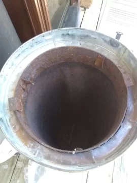

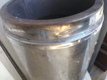

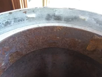

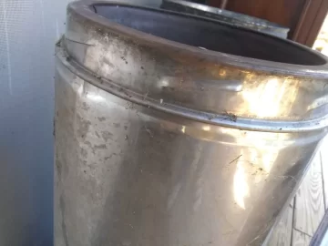

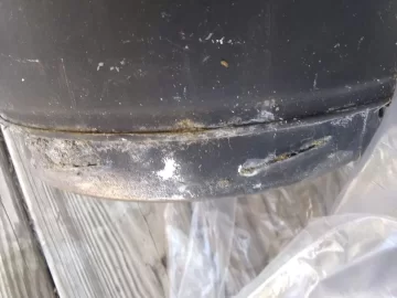

I'm trying to replace a few of my double wall pipes that were here when I purchased the home, I checked the pipes and no name, company, numbers or brands on any of the pieces. How do I find out what brand I have? Thanks for your time.

That is chimney pipe. It looks like it might be Duravent's Duratech but that's just a guess. Are you replacing all the chimney pipe? Can you show the interior fittings and stove pipe that connects to this chimney?
That's the thing, we only have the pipe going through the ceiling with flashing, roof support and cap, no ceiling box or adapter, the pipe was supported by pieces of wood attached to the ceiling, we have a wood burning fireplace and just want to replace a few of the double wall rusty pipes, along with getting the box and adapter, the pipe that is still on the roof looks good inside, looks like those parts were replaced recently, but not the lower ones that I have pictured. We got on the roof to see if we could find any markings for brand but no luck.
