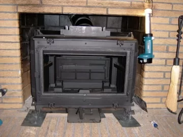

Ok I'm tired but here it is when I left, it was stripped of anything that wasn't bolted down..... It's about 500 pounds but stripped it was about 200 pounds much easier to maneuver, more to follow...... also Turner & burner took pictures of me clutching to the chimney for dear life maybe he'll post them soon. :cheese:

O.K. .......Picture.......Thats better , that'll hold Ole' BB from haffen to take his meds for a wile.
(shuu .... We wouldn't want BB to get riled up u know )
All looks good so far.
BTW, does anybody elses back hurt just looking at that picture , I know mine sure does.
