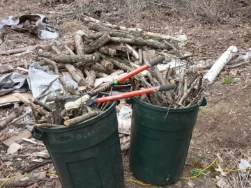

Twigs for DHW, yup. Have the slabs off and am trying just burning enough to make the 40 gallon indirect a few times, charge, draw, recharge, burnout. Two days, three tanks on one barrel. Time for a bath. [Hearth.com] Twigs for DHW

I'm using all of the scrap that happens from splitting. Its all nice dry oak. I've got a nice size pile from the 18 cord I split.
45 min burn brings the WG up to 200*.
Once in the morning and once in the evening.
Enough to keep the DHW indirect charged all day.

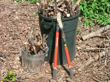

[Hearth.com] Twigs for DHW Got another picture. I'm getting the routine of what to do without weighing the wood. The galvanized 2 gallon pail filled with 1"-2" twigs is the perfect fuel load for what I'm currently doing. Brings the 1280 lb Froling up from 23 C and makes two hot tanks of the 40 gallon Gold plus indirect DHW. Learning the system, tight pile of larger to smaller right over the nozzle, tight as possible, and two shovels full of bark and splitter debris on top. Yup. That's with the slabs off and no slumbering. Just have to draw the first tank when it's ready, ~ 45 - 50 minutes. Tank aquastat is set up in the scalding range and the second recharge tank is good next day.
It's a little fussy at startup. Have to leave the lighting door open until the flue gas reads 125 C or so. If not, it snuffs the flame and gasification and smokes. Burns sweet and clean otherwise. Reminds me what an awesome campfire in a can this thing is. That's what the picture is for. I'm sure there readers who want to call BS and say you cannot bring up a cold 1280 lb Froling and make 80 gallons of DHW with 2 gallons of twigs, but it works for me. Exactly what I wanted, heat and DHW, without having to worry about feeding a large quantity of fuel.
