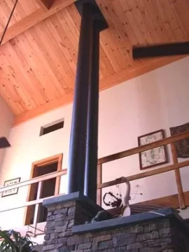

Trying to finalize the Masonry heater going in the great room.
I also want to have a 2nd flue coming from the basement.
The question I have is about how to penertate the cathedral ceiling.
Roof is a 10/12 pitch, it will be penitrating about 1/2 way up (24' wide room, so 12' from wall to peak)
1) Should I frame a Chimney , or just let 2 flues stick out of the roof.
I was thinking of framing a Chimney chase about 5' high with a cricket, and capping it with a S.S. top pan that the 2 flues would penatrate.
2) do they make double cath ceiling boxes ? I have not seen any ?
3) this is on the back of the house, backing up to the wood, no one will ever see it.
Going all the way up with masonry would be to "over powering" for the great room.
attached is a picture of what I have in mind ?
Thanks for any idea's,
Nick

I have a TempCast 2000 masonry heater on the main floor and a Harman TLC 2000 wood/coal metal stove in the basement. There is single wall steel pipe in the exposed area from the top of each to an insulated box with Class A insulated steel pipe for the main floor and roof penetrations. The basement stove chimney is visible, and part of, the main floor masonry unit with wood storage between the two as seen here:
https://www.hearth.com/gallery/pics/fireplaces/source/tilestove.html
I didn't do masonry chimneys because I wanted the heat output from single wall steel chimneys in the living areas. On the roof, a chase was made to house both chimneys, both Class A insulated steel inside the chase.
Now in my 6th heating season, everything works like a charm.
