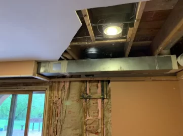

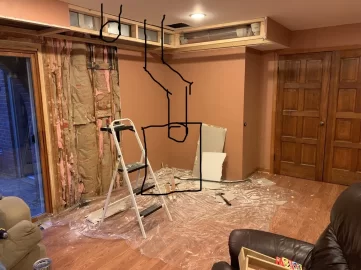

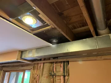

I’m limited by the height between the top of the stove and the soffit. Here is a photo. I’ll try to edit it to show what I mean. Sorry for the crude sketch but I think you get the idea. The stove has to move closer to the sliding door and can’t tuck back into the corner.
[Hearth.com] Two 90's in Stove Pipe
You need to tear the duct out of the way. Cant go around that with elbows. Not what I expected at all. Plus I dont think you would have near enough clearance from the wall to begin with. That looks like an abandoned b-vent anyway.

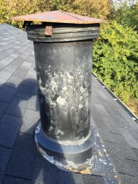

Like I said, the duct is getting moved. Imagine it's no longer in the way. It's getting moved out towards the middle of the room. There's enough clearance there but the stove pipe needs to be double-wall. It's a flue.....the chimney is still on the roof but in bad shape. The home had an old Buck stove that was used for almost 40 years. Previous owner tore it out, capped off the flue, and put duct up underneath it.

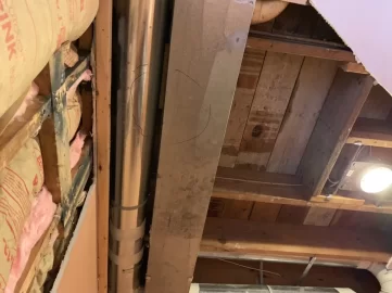

If I remember correct, you have a chase coming out of the roof that houses the existing pipe?
From the pic it looks like it is smack against wood. Verify adequate clearances before attempting to put back into service and if it is indeed class A.
He is having a new chimney installed
Nah, it’s not smack against the wood. And that metal flue looks like it’s almost a foot in diameter or maybe more. New 8” flue should fit in there fine I’d think. All that existing flue and chimney is getting torn out. That’s factored into the labor quote in my other estimate thread.

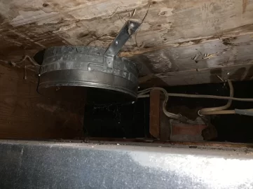

Can’t show you a photo from below because duct is in the way.

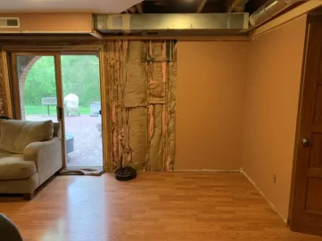

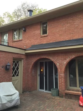

Better view to show why I’m trying to get the stove away from the door and couch. Should be able to make out flue in photo. Can always buy new furniture though. We made that couch work when we moved in. It’s a wrap around.
Distance from wall to door is 90” or 7.5 ft approximately.
