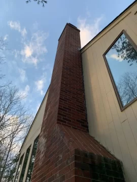

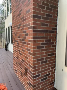

So the house we bought has a new oil furnace installed last year by the previous owner. It is vented up an exterior brick chimney and I did not know this and rather thought it was a direct vent. So currently there are two flues in the chimney, one for the furnace and the other for a propane fireplace that is being removed as well as it’s flue. I guess now I have to see whether both the furnace flue that appears to be 3-4” will allow for a 6” flue for the wood stove to be fitted. I think most of the chimney will have enough room and was planning to get a chimney sweep in but not sure how I am going to get a blocker plate to work now.
Has anyone dealt with this type of scenario? Attached are pics of them outside of the chimney.
View attachment 309379 View attachment 309380

Well from the pic I can pretty much see from the efflorescence that the furnace flue offsets to the left just above the fireplace. That also tells me you need a furnace liner as well unless that was done already
Tks @bholler, can you educate or expand on why this occurs? I am assuming you mean the white on the brick?
Yes the white is what I am referring to. It is caused by moisture condensing in the flue and leaking out through it and then the brick. It brings salts along with it
