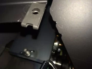

I'm putting the back pieces back on my Harmon P68, these pieces, one on either side are there although I didn't even touch them, I noticed them and wanted to know how they work and what they're there for?
They're on the upper top and they're similar to little clamps to maybe hold something in place tightly? They're both on the exterior.

Downloaded App, I'm loving it! Here's a picture of one of those pieces.

That little clip is called a fender clip. The hole in the clip is designed to accept a screw. The panel will have a mating hole.

it is just another spot to put a screw through if you want to but most people don't use them, the two screws the hold the side covers that "pinch" it are more than enough to hold your covers on steady, only if for some reason you get a noise coming from a vibration of the panel would I bother looking at putting a third screw there to hold the panels on extra snug.
