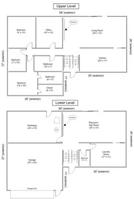

A local Regency dealer is having a sale on the Regency I1100, which is their small insert. The cost of two I1100's is about the same as one I2400 (plus an additional $1000 for install/parts for the second I1100). I am trying to decide if I should by two I1100's, or just one I2400.
My home is a two-story bi-level house. I attached a picture of my house dimensions to this post. Each level is about 1750 sq ft, for a total of 3500 sq ft. The attic and walls are well-insulated and I have triple-pane windows. There are two large fireplaces in the center of the house (one on each level, directly on top of each other). Each fireplace has its own dedicated chimney. On the lower level, I just need to heat the 300 square-foot room with the fireplace (it's my kids' playroom). The other rooms on the lower level don't need to be fully heated (work room, laundry room, garage).

I would go with the large firebox in the main living area. The 2 small stove idea would mean more issues with overnight burns much more effort tending fire and higher total costs. Also if you need to put in a liner for 1 stove vs 2.
The 1.4 cu ft firebox on the I1200 would scare me. It will be difficult to get decent burn times with that small fof a firebox. I think having two trying to heat the square footage you want to would be a battle.
I would start with the larger stove upstairs. I would even consider putting in the I3100 upstairs if you can fit it. The I2300 only has a 2.3 cu ft firebox, which is not all that big. Again, you may struggle to get overnight burns. The I3100 has a 2.9 cu ft firebox, which I don't think would be over powering with the square footage you have upstairs.
You can always add a small insert down the road as the budget and time permit. I think the I1200 would likely be about perfect for you downstairs.
If you had to burn the two small stoves your whole day would consist of running back and forth every couple hours filling the stoves. Go bigger!
The house is large. I'd put a small insert in the basement FP for when you want to use that room and an insert of 2.5-3 cu ft capacity in the main floor FP.
Or, depending on the heating system setup, maybe consider a woodfired boiler/furnace add on?

Thanks again for all your advice. This is increditbly helpful. You have convinced me to get just one insert, but I'm leaning toward a large unit, either the Regency I3100 or the Osburn 2400. Both have good reviews on this site. My last question is:
Should I install it on the lower or upper level? Since the large unit will crank out so much more heat than the small/medium units, can I count on the heat rising up to the upper level if I install it on the lower level? I'm worried that the upper level will be too hot if I install the insert on the upper level. Thanks again!
Put the heat where the main activity is. It will not drive you out of the upstairs rooms if placed there. It will only put out a lot of heat if it is filled with wood and given a lot of air. You control both the size of the fire and the amount of air it gets. The main advantage of the larger firebox is longer burn time. If it would fit in the fireplace, I'd be putting a 3 cu ft insert in.
