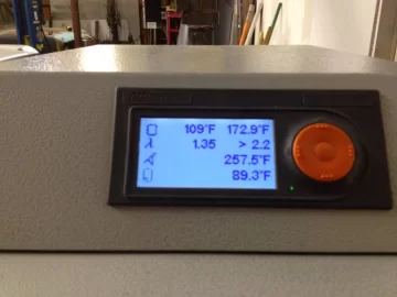

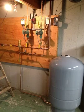

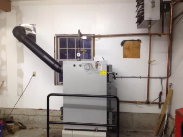

So, the two weeks have come and gone:eek: i bought a vigas 40 from Patrick Marks up in NH at Alternative Heating of Mount Washington Vally. First off a supper nice guy and a pleasure to do business with. Any way i got it all plumbed up and had my first fire last night. The controller is a little intimidating at first but once you use it for more than two minuets its really easy. I loaded it with an arms full of wood and a couple pieces of kindling on the bottom, blasted it with my plumbers torch shut the door and hit the button!! The water temp went up about as fast as the smile on my face:)

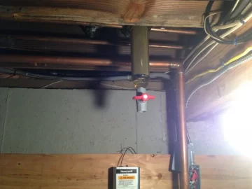

And, ..... that safety valve should be plumbed in a safe way towards the floor.
If somebody peeks trough the window when it goes off, he/she might loose an eye:mad:
That should keep them out.
Haha i have the parts to plumb it down, but my excitement of running the boiler got in the way. Still plenty of finishing touches to do

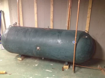

I cant wait until the storage come up to temp so i can turn on some zone pumps
You are gonna wanna get some insulation on that storage tank, or you wont ever get it up there! I ran my system for a few weeks without it to check for leaks, and it definitely heated my basement. Its a giant radiator at this point :)
But nice job getting it in and installed!
How do i get it up to temp when this damn protection valve wont let it circulate. The boiler is up to temp and idling.
is the LK820 in the right orientation?
what temp setting is the LK820?
is the pump running?
pump GPM?
No LK820 here. Just a 140 danfoss valve and a 3 speed circulator pump
The pump runs as long as the exhaust temp is up, so as long as i reset it every now and then the pump stays on.
