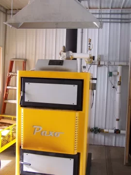

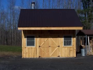

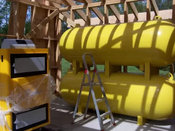

I will add that having dealt with Mark from AHONA in the past was a pleasure! Marks a guy who thinks outside the book.. He even designed his own boiler controller to let one go outside the limited boiler settings on some stock control boards.. So I would feel very comfortable with Mark.. He will never leave you stuck with any issues... Mark has even traveled hours to help customers who needed his help.. Just my 2 cents about Mark.. Great guy!
Boiler set up I bought from Mark from AHONA which went with my other house that we sold to buy our farm.. Again Mark was 100% to deal with.. He's there big time AFTER the sale...
