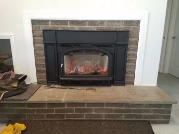

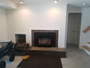

I just had a new Vermont Castings Montpelier fireplace insert installed. I purchased it from a store and they did their own install. I gave them the spec sheet with all measurements and they said it would fit fine.
However I noticed the wood trim on top was getting warm so I read the manual again and it is NOT within the minimum distance to combustible materials. The sides are fine, but I'm supposed to have an additional 14"(yes, FOURTEEN inches) of non-combustible material at the top.
My county requires a building permit so the inspector will be coming to inspect it soon. If he does his job right, it will fail.
1) What would you do? Try to return the stove? Brick the whole wall? Add some ugly trim? Gut the wall and put in a wood stove?
2) How much should the store be responsible to help with any costs? Is this my fault for not reading the fine print? I'm having trouble taking responsibility for this given that I made the conscious decision to press the "easy button". I paid them a lot of money to take care of everything - sell me a stove and install it. And they had all the measurements from the beginning.

Congratulations on you new stove!
Now, take a deep breath and count to 10 slowly.
Are you measuring from the top of the insert, or, the top of the surround?
It doesn't look like 14" from the top of the stove, but maybe?
And, does the inspector have the manual that specs 14"?
I'd let them come, and if the inspection fails, hold the installers to count.
If the installers submitted the permit, I bet you'll be fine.

The specs say 47" from the bottom of the stove to the top combustible trim. I have 33". The inspector does have the install manual with the specs.
I submitted the paperwork to the inspector myself, including all the details of the installer and their certifications to work in this county.
If it's not to spec I am tempted to point it out to the inspector to ensure he fails it. The wood gets hot if I burn the stove hot. And I need to burn it hot to heat this place.
I'm not impressed with the stove's ability to heat my place, nor with the super noisy fan.
If I have to spend any significant money changing the room I would have gotten a different stove, possibly a free-standing wood stove.

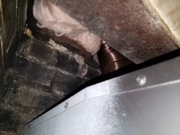

OK, I finally pulled off the surround to see if I have a block-off plate, and I do not. They seem to have just stuffed some insulation in the hole instead. I can feel the cool air coming down around the gaps in the insulation.
Is there any universe in which they can claim this is a valid installation method? [Hearth.com] Ugh! Advice needed. Brand new fireplace insert doesn't meet specs.
Well if it wasnt fiberglass it would be pretty standard and to code. You are not required to do anything there. But a blockoff plate is much better. I also see they squished the liner to get through the damper. Again not wrong but a half assed way to do it. The thing i do see is how dirty the firebox is. It makes me wonder if they cleaned the chimney properly
