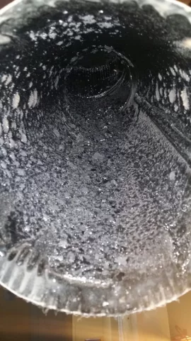

Did you get a chance to check the cap? This is about the time of year when its cold that they get clogged.
Here is the pipe above the stove. About a cord burned i would say.

I am at a step back and meditate point. I thought I would be able to maintain this from inside the house. I have the tools. If, after a month, I need to go up on the roof and clean the cap that is not something I'm going to be able to maintain which does not bode well for project wood stove.

I check mine with binoculars from the ground, only go up if I have to. The ones with screens are the ones that tend to get build up, if you have one with a screen that gets build up just take the screen off or get another style cap that's not prone to build up.
If that is the build up at the bottom, the top is prolly caked. Best check your wood, or burn hotter.
Spray the chimney cap with a garden hose. It will clear it of soot build up and your draft will be fine. Same thing happened to me last night.
