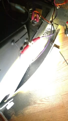

ok....i understand and i will clean it out tonight. if i understand this correctly .. looking at our stove there is only one disc (#)3 thats near heat, on the back side of internal stove itself..... the other two disc are out by the control box.
Sysko can you check if manual I posted is correct ....thanks
#3 should be on the auger tube, it is supposedly resetable. #’s 2 &3 are out on the side of the air chamber leading to the combustion blower chamber yes near the control box.

yes...the number 3 is resetable....on the auger tube. not challenging anyone here..lol cause we dont know much on these! but when u said the discs werent getting heat cause us ash.......it seemed odd to me the other two are so far away from the heat source. lol
does it make sense guys that 2 of the three disc are resetable and one isnt. im not exactly sure which one isnt not looking at the stove currently....but i do know the auger one , number 3 is for sure. this happened one other time and it tripped the 3 disc. why i was hoping when this happened last evening, i would just be able to reach back there and reset it...but it wasnt tripped
They all are for different temperature ranges. #3 is resetable because it doesn’t trip unless the stove over heats.
ok thank you, so this is odd...when i take the part numbers off the manual you provided and try to order them....the only on that is resetable using the factory part number is number 3 disc. I know for a fact i have two that are resetable . could our unit be older than the manual? and be a different type? or could someone at some point before we owned it.....put in a different snap disc....and is that a big deal? why i was asking if these discs are crucial to be exact. when i get home ill have to see if i can read a part number off the other two

Here is a picture of where the two out of the three snapdiscs are located on my
  • [Hearth.com] Ugh. Stove out..... Help please
I'm also wondering if I bypass the vacuum box with the paper clip trick does that also bypass the snap disc number 3?
