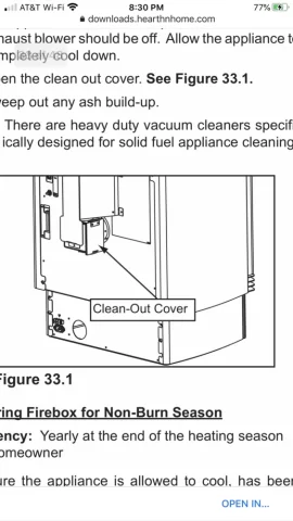

Ok so I just vacuum the stove.... remove top piece and bricks. Wasn't that bad at all but it's clean now 100% what about the little chamber
Does your stove have the center vent adapter for the exhaust? There is a cleanout door on it also. How is the stove vented?

No ours doesn't look like that in the back
3or 4 inch duravent straight out the back ....clean out....then up the wall to the ceiling out through the roof. Been like that since 2017.
