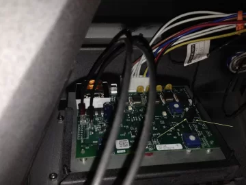

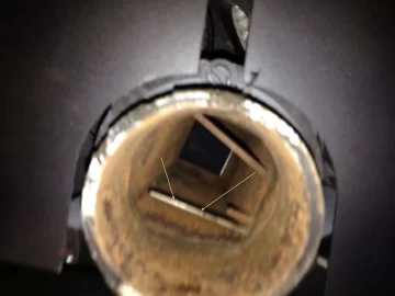

In your case of the 3 blink error, I would take the flue vent off the back and clean the ESP probe and then check the connector on the other end of the ESP probe to make sure it is plugged into the control panel securely. If it is dirty or loose, that maybe the problem.
See yellow arrow in pics below. Click to Enlarge.
Hope this helps

Thanks, Don. I'll take a peek in both those places and see what's up.

Thanks for the pix. What's that other ESP looking thing in the flue in your pic?
Board held in by 2 screws?...just pulls out?
Just the light from the flash bouncing on the edge of the firebox down towards the front.
2 screws and then pull and unhook the flange from the other side by twisting the control board.
The ESP wire is plugged into the prongs towards the bottom of the control panel
ESP connection seemed good. Went old school P38 style, under and up. Yes, I cut my hand doing it that way ;)
Cleaned probe. Just had the finest coating of powdery ash on it. One light swipe with the brush and it looked good as new.
