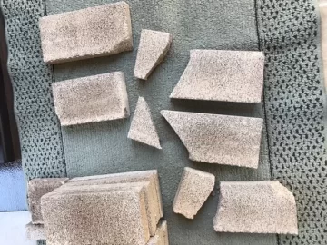

I finally took delivery of my new pe summit pedestal stove yesterday and had nothing but problems it was all quality control problems from the factory. The ash pan wasn’t even welded on one side and the metal strip that has the knockout for the ash dump assembly was on backwards with the knockout on the wrong end. I opened the fire brick up and discovered 5 broken bricks , I went to the dealer and got new ones and got them all installed so now I was ready to put the door on and I got it unpacked only to find the bottom hinge was completely broken off and it wasn’t in the packing anywhere which means it was packaged broken from the factory. I thought that I was buying high quality but apparently they have serious quality control problems and I don’t even want the stove now.

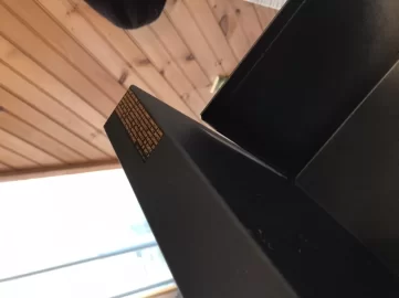

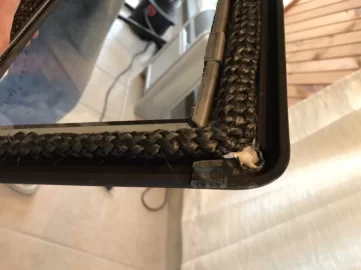

I took pics of everything and emailed it to Pe and the dealer...I will let you know how this turns out but I can tell you I’m not keeping this stove it cost way to much to put up with all the problems. I’m really disappointed I thought I had made a good decision buying this stove but I definitely didn’t. If your planning on spending almost $3000.00 on a new PE stove you might want to think hard on it or you might be in the same situation I’m in.
  • [Hearth.com] Unbelievable
The problem is not obvious in the first shot. What is that of? Did you document the broken bricks and the cleanout issue too?

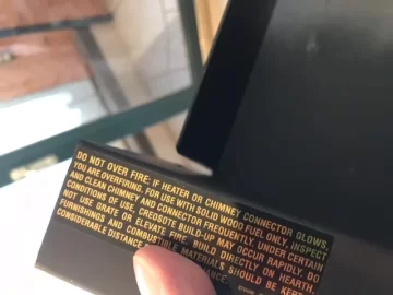

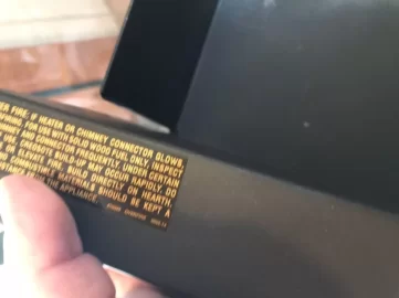

Here’s a better pic that’s the ash pan it’s not welded on that side. I have pics of everything here they are

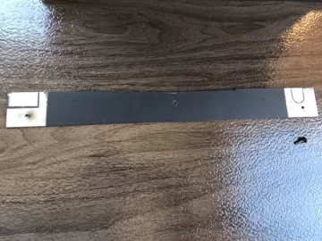

The metal piece has the u shaped knock out on the wrong end and that’s why I couldn’t figure out how to get the ash dump handle through the front of the stove, if you turn it over it’s silver only painted on one side but I fixed this myself marking off the proper end and cut it out with a small hacksaw but I shouldn’t have had to do that it’s all poor quality control issues

I took another pic of the ash pan really cheap made.
