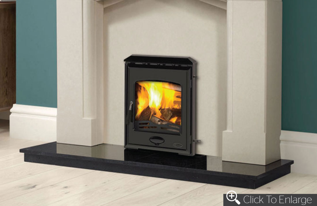

I've no way to check the flue temp, it's an insert, this kind of setup: https://www.fireplacesireland.ie/wp-content/uploads/2016/10/Arklow-5.jpg

Do you think there's too much air getting in from the back? If so, would that be a manufacturer or fitting fault?
I don't think it's likely to be a mfg. or fitting defect but with the amount of draft a 23' chimney creates, if the stove is an easy breather by design so that it will work on short chimneys, then in your case that may be too much air.
My wife's sister's stove, was burning borderline hot on only 16' of chimney (that brand of stove is known pull a lot of air.)
Hers is a free-standing stove with exposed connector pipe, so it was easy put in a flue damper. Not sure how you could do that on an insert, though..
