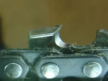

He is looking at the bottom of the gullets getting to small. Maybe a under size file or just not getting it out of there good, but quite silly to think this would be a bar issue. Hes cutting with the top of the tooth AND GULLET CLOSING UP and or not clearing chips when using the bottom of the bar.
  • [Hearth.com] Uneven cutting; but not what you think
