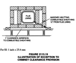

It's flue liner + masonry or block + 2".before combustibles. Only if you have the two inch is it correct.
So as described the interior chimney is the flue correct? If so a cinder block and standard brick is way more than 2" from combustible. materials. I don't see why I would need insulation blanket?
No the outside of the masonry structure needs to be 2" away from any combustible materials.
An interior vs exterior chimney is in reference to the whether the chimney is inside the structure of the house or outside.
Here is the diagram from the code book

Then I think I'm good to go
