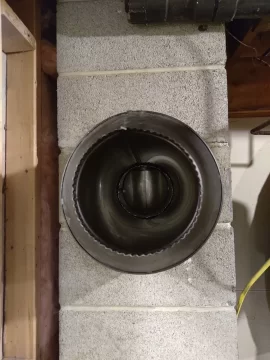

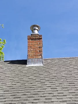

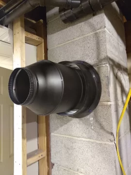

Just wanted to follow up since everyone was nice enough to share advice, and someday someone else may read this thread for education.
Successfully put a bare 6" liner down yesterday! Interestingly I tried with a pulling cone first (one person on roof and one down below), and it got stuck. We suspected it was the tension bolt/band on the pulling cone that was getting stuck so we removed it, and I was able to get the whole liner down from the top without the cone. Everytime it stuck I just spun and pushed. Only took about 5 mins to go all 26 feet.
The tee was a real pain. Because it's wider than the liner I didn't wanna risk feeding it down. I put it in the clean out door and used a string to pull it up to the crock/thimble hole. There was some crap in the way I had to reach in the crock and cut out just below, spent some time wiggling everything around, and had to fish the tension band on the snout around the back of the tee, since the tee was actually too wide to slide up the chimney far enough to get the snout band below it. Anyways, in the end I got everything fully seated and well tightened. Cut the snout off a couple inches inside the masonry and crimped the end, jammed my insulated wall thimble over the crimp and screwed tight to the chimney with tapcons, per the instructions. Just gotta come back with some high temp silicone around the collar (somewhat irrelevant since my liner to thimble is a fully enclosed system now, but just wanna be extra thorough).
The two piece chimney cap system went together great. Overall really happy with this Rockford chimney liner customizable system. And super happy I did the research here and took the time to do it. Definitely feel a lot safer. I didn't take any pictures during the install, so apologies for that, but here's some pics of the small amount you can see now that it's complete.
