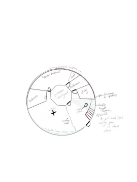

The house in total is around 2200 sq feet though that’s a rough math estimate because the house is not just round, it is a donut.
The stove is downstairs and right now the upstairs gets plenty warm, the far reaching and even near the stove in the downstairs areas, not so much.
Here are my questions:
- there’s evidence that there once was a small (30” or so) ceiling fan above the stove in the double-height space, maybe 8-12 feet above the stove, should I put it back?
- there is a ceiling fan in the “great room” with the stove- should I leave it on? Will it do anything?
- I’ve tried to divide the “great room” with a curtain to try and get more heat into the bathroom, that’s minimally effective: any other ideas to try?
- I have a fan in the bathroom door because I though perhaps I could blow cold air out, but it’s mounted high (to avoid trip hazards), is that mostly counterproductive and blowing any warm air out of the bathroom? I’ve read that trying to suck warm air in would not be as efficient.
There is a labeled “master bedroom” which we are not currently using because it’s just so cold. My main concern is honestly just to get heat into that bathroom, which is less than 20ft from the stove itself but around kind of a corner with a narrowed hall.
Enjoy my rough sketches, let me know if you have more questions and thanks in advance for any input or creative ideas!

Definitely get the ceiling fan working. most of the heat is stratifying up high. Consider going up to a larger 50 or 60" fan. To get heat in the bedroom, open all doors and place a box or table fan on the floor of the bedroom, pointing out the door near the bathroom so that it is blowing cool air out toward the stove, past the utility room. This will help start a convective loop.

Thanks @begreen! I wish we could do a larger ceiling fan above the stove, but because of the size of that “wedge” and where the stovepipe is, any larger and we’d be whacking the blades on either a window, a wall, or a stovepipe.
Would you recommend nixing the curtain divider of the large space then, in order to get a full convective loop going?

The picture shows the ceiling fan far away from the stove. Is that a second one? Yes, remove the divider for the floor fan test. Give it about 30 minutes and measure the temp in the bedroom before and after.
Sorry, my bad: there's an existing ceiling fan, as on the drawing- that one is probably a regular 52" fan or so, but there's definitely space to go up to 60". The small 30" fan I was referencing is where I think there was a fan, above the stove (the fan hanger and electrical is all there, just dangling), so not on the drawing. I guess I'm not sure if it should be put back up? No idea why it's no longer there. My thought is if we put it back perhaps we could prevent all of the hot air from going straight into the upstairs by pushing it back down?
