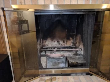

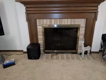

I have an exterior chimney that serves two hearths. One in the basement and one in our main living area. As I mentioned, I already have a PE Summit doing its thing in the basement. Now we are getting ready to remodel our main living area which includes wanting to do something with the existing hearth and fireplace. Primarily to provide some secondary heat on the really cold nights.

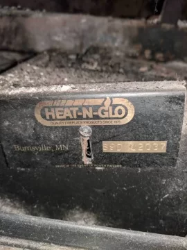

I believe the unit that is currently in place is some sort of Heat n' Glo prefab (see attached pictures). There is a blower unit in the right front area of the fireplace that has a Heat n' Glo plate but doesn't offer any details on the model.
Quick dimensions of the opening (taken with the pre fab in place - rough dimensions might be slightly larger).
24" D 36" W 30" H

I forgot to add, there looks to be a gas valve control in the brick out in front of the stove (right under the reindeer in the pic). I assume they had a gas stove in there at some point. I'm guessing I will need to rip that out but not quite sure how to go about that. My first thought was to call our propane company to have it removed safely but not entirely sure.
The fireplace looks like a masonry firebox with a poker style damper. The heat & glo unit appears to be a blower/grate thingy (that's a trade term so you may not be familiar with it) which you would just toss in the garbage.
If it's as it appears I'd go with an insert into the fireplace. You'll have to install a liner and such which will require some cutting of the damper frame and such. A big consideration will be clearances to the mantel. Keep in mind that most clearances refer to areas thicker than 3/4" from the face of the fireplace so some of it may not be a problem. Check the clearances with the stove mfg. for clarification. You may consider removing the mantel all together and go with something else.
Depending on the size of your firebox you could also raise the hearth off the floor by a course or so of brick OR simply install 20" deep preformed hearth stones cemented right on top of the existing brick. You'd get the extra depth you'll likely need and only be 2 inches higher than what it sits now.

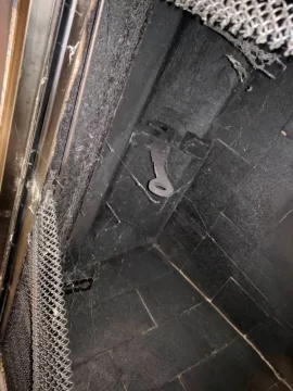

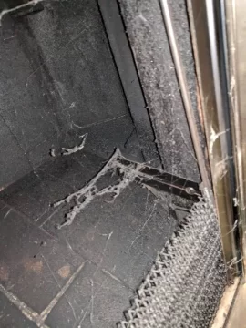

What makes me think its a pre-fab is the firebrick that's inside. It's not the same as the chimney but maybe that's intentional? I guess I need to get in there and start ripping things out to be sure.

Firebrick are used to lay up the firebox. They're not the same size or look of common brick. Yours are laid up on their edge so you see the full face of the brick, about 4.5 x 9 inches. It's a masonry firebox.

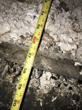

New question on floor protection. I did some searching on this and wasn't successful in finding anything with regard to the Ashford insert.
Here is a quote from the Ashford Insert manual.
"If the bottom of the appliance is 5” (125 mm) or more above the fl oor level (combustible material) only ember protection is required (UL 1618 type 1) extending 16” (407 mm) in USA or 18” (458 mm) in Canada in front of the door and extending 8” to either side of the door opening. If the bottom of the appliance is at floor level (combustible material) or less than 5” (125 mm) above floor level, a layer of non-combustible thermal protection (UL 1618 type 2, where R=1.06 minimum) is required under the appliance extending 16” (407 mm) in the USA and 18” (458 mm) in Canada."
I'm trying to confirm what constitutes a non-combustible material where R=1.06. I am putting the insert into an existing masonry fireplace. Does the floor of the existing masonry fireplace meet the requirement? In addition, we are putting in a cut stone, (2 1/4" thick) for a hearth extension which will go out 25". Does the cut stone meet the requirement?
That’s a high rvalue requirement. There are tables showing r value per inch of various materials. 2.5” of stone is almost certainly insufficient.

This is take a little more planning. I would think about making a compliant, non-combustible hearth that extends to the back of the fireplace firebox. This can be topped with a stone tile and edging. To build up to R=1.06 you could use 3 layers of 1/2" Durock NexGen and then top with 1" cut stone or thicker.
Thanks all. Looks like 1/2" Micore Fiber Board will get me just over R1 and 2 1/4" stone gets me up over the R=1.06 requirement.
R-values
1/2" Micore = 1.03
1" natural stone (limestone) = .06
It's interesting because this is a masonry fireplace built to burn directly in it - seems odd that an insert would have this additional requirement. Anyone know what that is with this insert (and others)?
