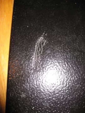

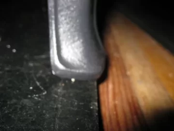

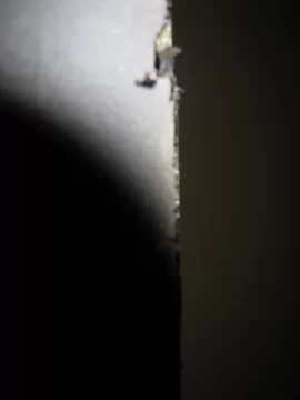

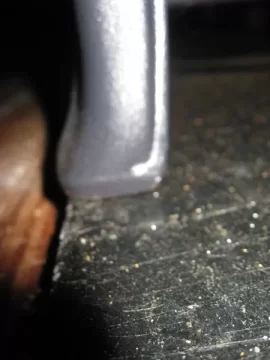

I posted a thread a while back about a problem with an installer when they couldn't cut through the damper due to it being super tough healilator steel. They had broken 2 sawzalls on it. Well the dealer agreed to pay for someone to come out and cut through it with a torch, and that was done a few weeks ago. So yesterday the installers come back to drop the liner and hook it all up. Both me and my wife were at work. When I came home, the following issues were evident.
1. The stove legs in the front were hanging over the edge of the hearth. Not by much, mind you. Move it back a half an inch or so and it would be golden.
2. The spark protection pad which sits in front of the hearth was smushed and scraped in some spots. Clearly they had set the stove on it and moved it around some.
3. They were supposed to mount a mantle shield, but did not bring the spacers for it. (DOH!) They left it sitting on the stove. For some reason, they had cut it to make it narrower, and had left a fairly uneven and very jagged edge.
Are these legitimate concerns? I called the stove place and they are supposed to send some people out soon to install the mantle shield and hopefully address the other problems. Who knew that installing a stove could be such a pita?

Hallelujah! Just got off the phone with the dealer. He agreed that the installers had screwed up. He is sending out a different crew on Tuesday to fix everything and replace the pad. This will make 4 times that someone has come out for this dang stove! I can't imagine what it must be costing the dealer to keep sending folks out here. What an odyssey!

That's a nasty ragged edge on that heat shield. I wouldn't want that anywhere near my mantle!
