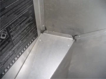

I have had a little trouble with this in that I have to open the hopper and push the pellets towards the auger side once in a while. They tend to hang up a bit throughout the day so I decided to try the fix that others have mentioned here.
First, I emptied the hopper and taped over the auger opening, then vacuumed it out. I then took a scotch pad and sanded all the inside surfaces of the hopper making it smoother, then vacuumed again and wiped several times with naptha (lighter fluid). I then put metal tape over the rivets/screws/seams (not the vertical sides) and I applied a good coat of silicon, rubbing it well into the metal with a final dry wipe. It sure felt much slippery-er.

Here are a couple of before pics:
  • [Hearth.com] **UPDATE** Pellets not sliding well in hopper - My fix w/pics
Here are a couple of after pics:
Did you start at the bottom and shingle the tape to the top? That will help keep the edges of the tape from rolling up . Looks like a good job. I wish I could get into my Castile insert like that. I can get in up to my forearm and barely touch the auger. I use a mirror and tools, and stuff, to clean out around the auger. Good Job

I'm really not sure what the temperature rating of the tape is, I've had that tape for many years and have used it to wrap the exhaust of my skid steer which held up just fine for a long time. I know that the walls of my hopper get hot, but definately not near 250° or much greater than 100°.
Yes, I did put the tape on the lower portions first, then overlapped them with the upper layers (like shingles). I should know in a few days if it helped at all, but it certainly can't hurt.

Just a quick post to say that after performing the above I filled the hopper to the brim and let it empty without touching anything which took a few days and it never had any problem at all supplying all the pellets needed to cover and supply the auger.
When I first got the stove, it did shutdown because the pellets wouldn't feed the complete hopper, so this fix really made a difference. I won't have to worry about the stove shutting down when we're not home or through the night because the pellets got hung up in the hopper.
