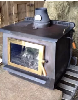

i currently have a PE Spectrum classic with all the nickel trim, legs, and door; i think it's one of the best looking stoves I have seen. We really like it and it does a good job heating out split level 2000 sq. ft. home nicely from a central location in the lower level near the stairs. Recently I found a pretty good deal on a BK king classic with gold door and blower kit. I was told it was 7 years old and only burned for 2 seasons (picture attached). I am wondering if it is worth the hassle to change it out from our current setup? Will I notice a big difference in heat output? I know burn time will be way better but I am more curious about constant heat output. Also, can a BK use an adapter down to a 6 inch pipe? I have attached pictures of my current stove and the BK that is for sale. Thanks for the opinions.

You like the looks and performance of your current stove. Why are you even considering upgrading? You haven't mentioned one thing you are unhappy with. Don't try to fix something that isn't broken.

You have a good looking stove there. The thing with the king is that you will have possibly more control over burn rates that at the same time will give you some saving on wood usage. Once awhile you hear people using it with an adapter but is not recommended. Is hard to tell you that you will be making the right decision regardless I am a BK fan.lol It requires 8" chimney for good performance.
My only issue with my setup is overnight burning. It does well as long as it doesn't get below mid 20's outside. Anything below that and it struggles to keep the house warm for an overnight burn. With only a 2 cu. ft. Firebox I don't think it's fair to expect it to keep 2000 foot house heated all night when it's 10 degrees out. But it sounds like people think adapting to a 6 inch pipe is a bad idea so I think I have my answer. Thanks for all the opinions!
I know you said it was a good deal but if you still want to replace it with one that give you an overnight burn, there are a lot of option out there with 6" pipe that will get you thru the night. If looking in specific into BK line, you have lot of choices also.
