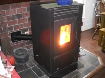

Therefore, knowing the older Enviro Max and Mini has some issues running on the lower heat settings, we popped in a new circuit board with new decal into a 6 year old Enviro Mini. Who knows what other good fixes are in there!
The new board has the Room Air Fan On/Off button on the board in the lower left but is not used in all models. Therefore, the program chosen for the model stove that does not require it, as in the case of the Mini just locks it out and the Mini Decal just covers it up. However the trick here is when programming the board for your model stove, you have to press thiis button along with the the Feed Rate Trim and Combustion Air trim simultaneously to program the board! LOL
So if you have the light gray decal and the 3 position manual, auto-on/off and auto-hi/low slide switch in the horizontal position above the other buttons you have the old board. The new board has a vertical (Up/Down) slide switch.

Has anyone else done this upgrade? Any comments?
See pics below.
Enviro part # 50-1929 - $329.95 from your friendly and knowledgable parts dealer
It works much better!
See Circuit Board Install Sheet in this PDF link.
