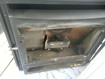

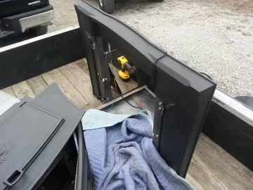

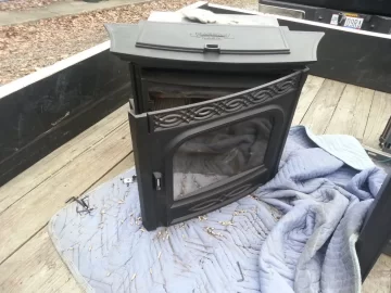

I bought it for $1700. I got the stove yesterday, everything worked. We let it burn until the blower came on. They even loaded it on my trailer. Cleaned it out with the air compressor outside yesterday, sat the frame in my fireplace. Going to get the chimney cleaned before it goes in.

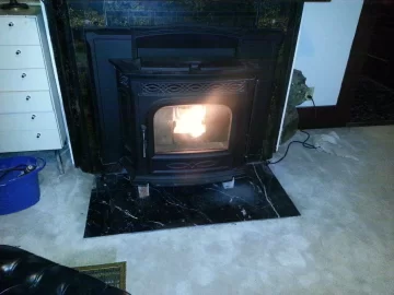

I know it has been a while. Finally got the chimney cleaned then I installed the stove it has been running great. I have been running the P35i and the Accentra simultaneously on temp mode at about 67 now instead of constant burn on the p35i. My house temp has been much more even throughout (No cold/hot spots) and I have used virtually the same amount of pellets I was using before just in the P35i. I do use more pellets on nights when the P35i would have not been enough to keep my house warm. On warmer days I am using the same amount of pellets.
Forgot to pull out the blocks I use to roll it it and out underneath before I shot the picture.

I got it in just before the last cold snap ended. I have both on now even with it being warmer to keep the house more evenly warm. Like I said can't tell any difference in pellet usage. I am definitely all set now. All 3 fireplace filled.
