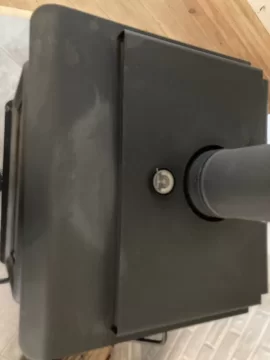

I am looking at a used BK Sirocco 30.1. It seems in good shape, but I see discoloration on the stove top. Picture below.
Could it be due to overfiring? Should I be worried?

Thank you! I wonder what I’ve done differently on my princess, which I have burned A LOT in for 4 years. The top still looks new!
The princess I am using looks like that or worse. Do you run your stove low most of the time?
Most of the time on low to very low
This stove was probably run higher like mine is. I have absolutely never run very low and only run low a few weeks out of the year
Makes sense.

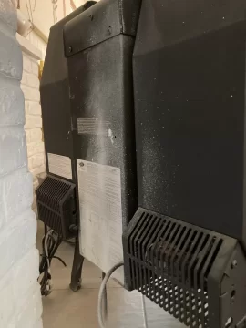

last question. There is some paint on the certification sticker on the back. Is there a chance this could cause an issue getting the stove WETT certified?
i am being paranoid but don’t want to spend money on something I can’t use!

For over fire damage on a BK you need to check the bypass gasket retainers. Big deal to fix this damage if it happens, even requires cutting and welding if it’s bad enough.
Look inside the firebox, up at the top where the bypass door closes and seals. There is a gasket there with thin steel retainer brackets that hold the gasket in place. If these retainers get too hot for whatever reason they can sag down like butter and fail. It happened to me and others.
Just check them. The bypass door should close tight and prevent a slip of paper from being pulled out of the gasket seal all around.
The paint is easily fixed and looks to be more because this guy scrubbed the stove top clean. Cats get very hot at low burns and that semicircle shape corresponds to the hot spot over the cat. The paint then gets weak and can scrub off.
That paint on the back should be removable. It looks like overspray from the wall paint. Maybe latex?
Yes overspray and I assume latex. Not sure how easy it would be to remove

I have the same semi circle in the paint on my sirocco 30.1 - it's directly above the cat. i also have a bit of fading on the front of the stove at the top, directly across from the cat. I don't think i've overfired my stove.
