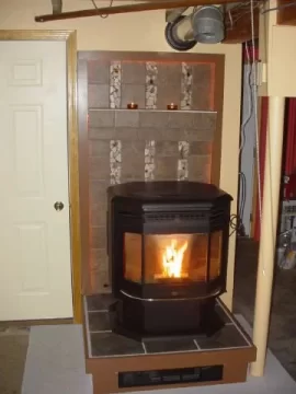

    I have a 30 foot Cinder Block Chimney with ceramic liner.
    After doing research and using it this way for 2 years I found no additional liner was needed. See pic below.
    I did have the Oil Boiler connected to it, so before I installed the pellet stove I installed a double wall stainless steel chimney for the boiler.
    Nowadays by code you cannot have any 2 heating appliances on the same flue. It will fail inspection and insurance companies do not accept it.
    However it would probably work ok except you may have problems with draft. The new heating appliances all have blowers that will buck each other if using the same flue. That is the reason.
    The blowers in your burner and pellet stove creates more draft when running so the fire in your boiler and your pellet stove will get too much combustion air when the other appliance is running. This extra drafting at times creates uneven burns and changes the efficiency and air flow and also cause back drafting!! Let's say for an example, that when the pellet stove exhaust blower starts up it creates initial pressure in your chimney and will cause the air to not only go up the chimney but also go down the chimney and thru the boiler and out thru the burner's air intake. If their is any CO (CarbonMonoxide) combustion gasses in the boiler from just being on, then the CO will come into the living space and that is a danger and a health risk. Granted the amount of CO would be small and most likely not cause a problem but, this is against code and is totally unexceptable to any health official or code inspector or insurance agent.

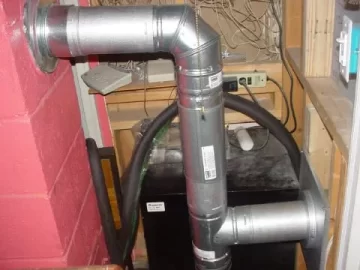

    I'm not sure what I'm looking at..is that your boiler...looks like it is vented into the chimney and also somewhere else ( the right side of the photo???)....is this what you did to your boiler???...I'm confused??

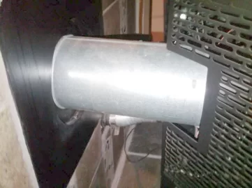

    Hello
    What you see is 4" Pellet Stove Pipe, the right side goes to the back of the pellet stove thru a tiled cement board wall within the proper wall thru. The left side dumps into the chimney. The oil boiler now is completely separate and out of the picture.
    See stove adapter connected to Pellet stove and wall thru in pic below:

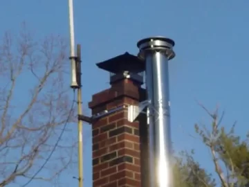

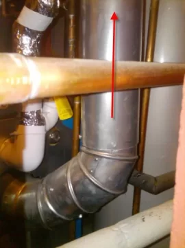

    No, the oil boiler has it's own stainless steel chimney now strait up behind the original chimney that the pellet stove is now connected!
    See pics
