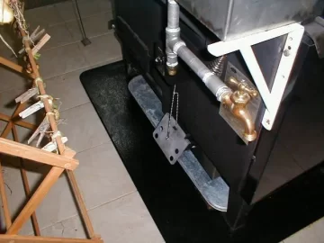

Mine worked so well kicking it up in the morning, I added a themostat intake into the ash pan area.
Be aware this is an Amish built stove that I talked with the builder / owner who adds something similar to many Amish wives cookstoves. (Stock on Hitzer hopper fed coal stoves) They all love it, and it gives it coal burning capability. It also voids the UL listing, but Amish self insure, so it's not a problem. As it heats up, the bi-metallic spring closes the intake preventing overheating. It was too easy getting busy in the kitchen to leave the stock intake wide open and get too hot.

Grate is 2 feet from stove top. 20" wide, 22' deep. Never built a fire to the top, here's what 3 logs looks like on the bottom with thermostat wide open. Oven lever is "ON" so exhaust is going sideways under oven, away from cooktop. Otherwise flames reach bottom of pan set over open hole.

This is the same square inch area as stock intake, just relocated under grate and there is a huge difference in ease of starting and oven preheat time. This is firebrick lined, 1/4" steel plate stove.

That's my point. Instead of opening ash door in front, my controlled intake under grate closes automatically so it can't overheat. If the manufacturer designed it with X amout of square inch intake, measure the open ash door square inches and you get the idea of how many more times the air is you're giving it. It's a crazy amount. Intake area is sized for the grate area. You shouldn't exceed it.
