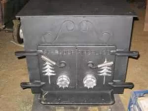

I live in a very old house with a stone fireplace. The other day I saw a used Schrader wood stove and I thought it might work in my house. The pipe comes out the back of the stove,I want to run it into my old fireplace opening and then up the chimney. First is this a safe way to install it and how far would the pipe need to go up the chimney?

Your installation method that you are referring to is common. Pipe out the back of the stove, and up the 'ol chimney. Be aware, that you have lots of clearance to combustibles to be concerned with (in front of stove, to mantel, etc.). Best case scenario is to line the old chimney with a liner to increase draft and decrease the amount of work it takes to clean it (sweep).
Now, that 'ol stove. What a hunka, hunka burnin' love. That was a heck of an old beast, but thats the problem, its an old beast. Commonly referred to as a smoke dragon, that thing is gonna LOVE to munch on perfectly good stove chow, just to blow an amazing amount of the fuel right up the stack (this can be minimized with good burning habits), but its gonna eat wood.
EPA cert. stoves are a safer, more efficient, more responsible way to burn. And for not a ton of bucks, there are several models on the market that are a great bang for your buck. If money is no object, then your choices are many.
I can get it for about $300. I looked at the cheap one a Lowes,the one like I saw you guys say is junk in anothe thread and I have to agree,it does look like cheap junk. The next lowest price one I can find is around $500 up from the real cheap $189 model. I went into this thinking I was only going to spend $200 now I'm at $300. I can't afford to spend any more then that at this time :(
