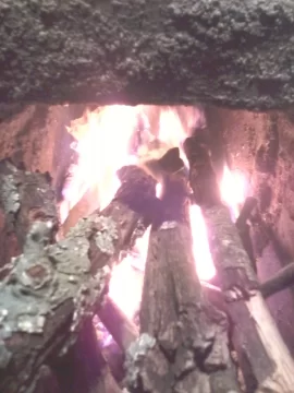

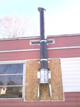

I made my own double insulated stove pipe using heavy duty black stove pipe and filled the space in between with thermix loose fill .I also used a reducer at the top of the stack.I joined the 6 and 8 inch pipe at the top and the bottom.I caped the fill with refractory cement and put rebar in so the fill wouldn't fall out.I attached my directional wind cap on top.It draws great and looks great.Cool to the touch outside .It isn't hot when it exits the home anyway.Steam comes out my chimney cap instead of smoke.Awesome rocketstove only uses sticks.The top of the barrel has been 400f.But the pipes have never get too hot to touch.

My homes paid for so I don't carry insurance.Nonetheless I love my home and take good care of it.I never fail to address anything that needs fixed however I bought it in fair to good condition for very little and it's had a lot of repairs done on it.Unfortunately for most people insurance and codes are an issue .Building this type of rocket stove with bricks and barrel with mass makes a huge mess .I have 2 leaks in my pipe inside.When it cools down water drips out of the pipe.Condensation is a issue with these stoves so the pipes must be water tight.It would be great in a cabin or shed.Its taken me a while to build mine and I still have to cover it in cob.Its an ugly beast right now.
Just in time! How's it cookin'?
Its hot! haha
I wanted to share this with you just in case you know anyone that might want to build one. I've taken a more pictures of 'the beast' and will upload them later for you to see.

I'm putting stucco on the outside wall where I closed off a leaky old roll out window.I need to treat the OSB board LATER.I'm waiting o a few warm dry days . I'll paint it with some oil based paint first to seal it.
