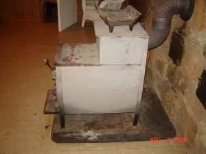

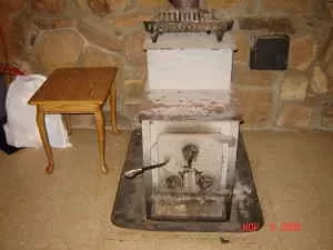

Saw this on Craigslist for $200, Black Ponderosa Wood Burning Stove - that's all the info I can get. Deal or not? Remember guys, I don't know anything about stoves so don't beat me up too bad.

I may be way off base here, but the only other stove I've seen that 'white' was one that was over fired during what should have been its break in period. Someone please correct me if I am wrong.

I would stay away from the stove above. I'm not sure why the stove is white. My first idea was that it was in a house fire and dragged out afterward. I guess you can get a white stove from overfiring before breaking in. Either way, it doesn't look normal and I'd be scared to fire something like that in my house. Keep looking on Craigslist and ebay too. What's your limit on spending? Also, have you looked at your chimney?

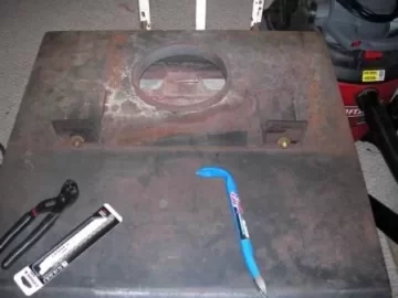

I put a deposit on it and will pick it up on Sat morning. Where it is located and the lay of the person's yard is going to make this a rough job. I wasn't able to find a model number on it because it is still installed and I think that most identification plates are on the rear area of the stove. It is in rough shape cosmetically, but all of the parts seem to be in working order with my limited knowledge of stoves. I wasn't able to fully determine if it is a CAT stove or not, I talked to a few of the guys I work with and from what I can tell, it is not a CAT stove. I got home late so I didn't get the chimney pics done and uploaded. If I get time tonight I will get some pics and upload them, trying to get some lights wired in the washroom this evening.

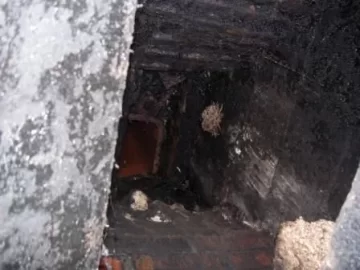

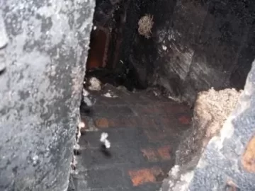

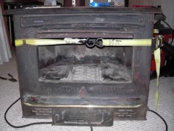

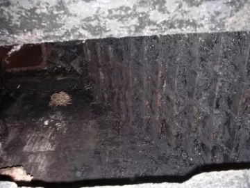

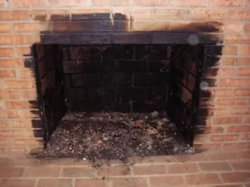

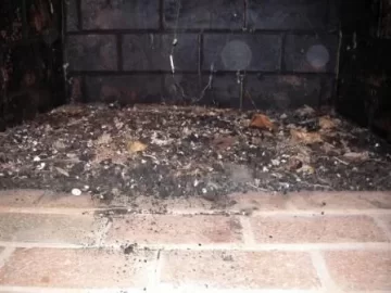

Picked up the stove today, well, mostly scooted/slid it. It is a Treemont Vansco, not sure if it is the TAC520c or the TAC260C, but it is a CAT stove. I opened the basement fireplace to find numerous items there, a few dead mice, one dead bird and tons of bird droppings, oh yeah and alot of creosote. I cleaned all evening on the fireplace and finally got it to a point where I could work in there without getting a face full of creosote. The chimney looks real nasty and in need of some repairs. I am in the process of removing the damper frame in order to fit the 8 inch pipe up into the clay liner. I have other pics but can only put one at a time and didn't want to post too many items.

May want to give that clay flue a good scrubbing before you get to far with running pipe up into it. Even if you are lining it, no point running a liner through a creosote / animal nest packed flue. I wouldn't rush to remove a damper, run pipe up through it (and put in a blockoff plate?) before cleaning the flue. A good cleaning now while there is nothing in your way would be pretty convinient - scrub it out and go to town with a shop vac around the damper opening etc. Bird droppings + dead bird + dead mice sounds like some likely animal nest findings. Best of luck with the install - post some pics.
